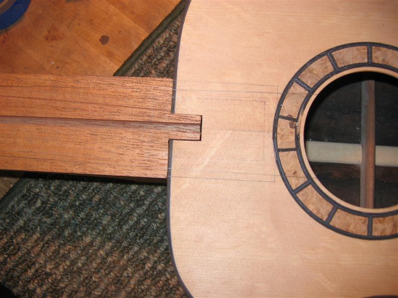

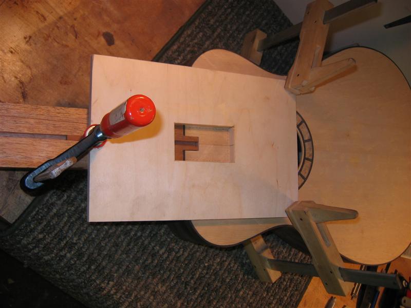

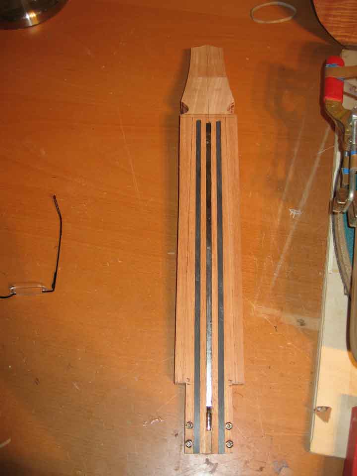

I'm finally getting around to working on the neck joint of my latest project and I need some advice. This sort of touches on the topic Andy brought up a few days ago, but I didn't want to hijack his tread. I'm tying a bolt-on double m&t joint. I like the idea of being able to complete construction and fretting before applying any finish. I seem to have difficulty avoiding nicks, dings and scratches after the finish is buffed out. The heelblock has a 1/2" thick by 2-3/4" qs mahogany tongue that buts up against the upper face brace. Right now the neck is attached with the conventional knock down hardware and the alignment is dialed in. I'm to the point where I can cut the mortise for the second tenon. I got to thinking that the joint might be stronger if I routed some of the neck away and had the tenon overlap both the body and the neck. Making sure that the tenon would be flush with the body, I could then glue the tenon to the neck, extend the truss rod slot, add some cf and finally attach the fretboard to the neck. After triple checking my measurements I made a jig that aligns off of the truss rod slot. I'm going to secure it with clamps and some double sided tape and cut the mortise with a 1/4" upward spiral cut bit. Lastly, since I'm mainly doing this to aid in construction I was going to glue the second tenon in after the finish is buffed out - although I do have the hardware for an all bolt setup. My question is, before I step out on a limb and take a router to my best work to date, is this sound thinking? Am I missing something/doing something stupid?? Candid feedback will be greatly appreciated.

I don't know if it's sound thinking or not but that's exactly how I do mine. I think it adds a lot of stability to the extension which is why I do it in the first place.I say go for it.

Bob, if I were you, I'd make the top tennon slightly thinner than the mortise from the start. That way, you are sure that the fingerboard is resting on the top instead of the tennon bottoming out in the mortise.
Scott, this is not a Taylor neck joint by any stretch of the imagination. To change the neck angle, you have to do a traditional neck reset. (removing material from the heal). What it does is give structure to the fingerboard extension which avoids the 14th fret hump.

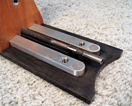

I designed a metal bracket made from a 4" x 1/4" angle iron that has one side going down as part of the heel's tenon, and the other, split like a two pronged fork, to accomodate the truss rod, going up the neck under the fretboard. It's a lot of work, but that angle will never bend. Now, if I could have an extension welded on that would go under the fb to the soundhole, it would provide the support of the carbon fiber rods and support the heel angle. One threaded hole would be enough to hold the extension in place.
I don't have any pics on my electronic camera (and have yet to figure out how to load them here--soon!) but there are photos of the neck bracket on my website, under the van Linge Guitars page.
Is anyone out there into making these out of aluminum? The tenon part could be set at an average angle, and the wood part of the tenon (I use 3/8" wood, 1/4" metal for the tenon) could be custom fit for any guitar. I haven't tried the Fox/Woolson jig, either, but that would still be great for getting the heel angle. I'm tired of fighting the hump, and will probably make one for my next guitar with a local welder. He can weld Al, too...

Here's an aluminum rig from eBay. The seller(not me) is Luthiers Cool Tools.

I couldn't find Luthiers Cool Tools. Do you have a link?
Or, do you remember how far up the neck those Al bars go--to what fret? Both questions, really.
